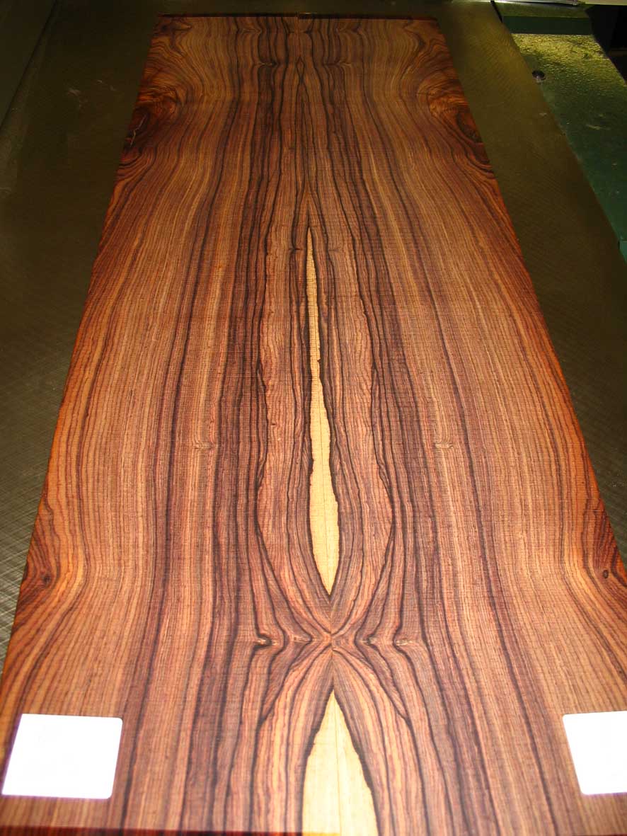

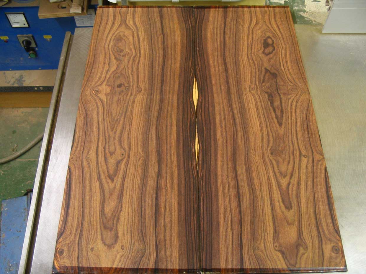

I am building a Couple of guitars at the moment as demonstrators. I decided to do one in a nice piece of Cocobolo I have (please see pictures if I manage to attach them, but I just can't think of what to use for binding it, any suggestions would be very much appreciatted.

Wow...that first set is really pretty! You selling?

I'm not selling, but the guy who I get it from has lots of beautiful sets, some from that same board, only trouble is we are both based in the UK, so not sure how the frieght etc would add to the cost, can give you his email if you want it Don?

Russel, is that some of Andy's Coco?
PostPosted: Tue Aug 02, 2005 12:54 am
that is some wicked sweet coco.

Colin yes the Cocobolo did come from Andy, he has some really stunning sets, ask him for some pictures.

2) Boxwood - Simple, elegant look that would showcase the nice figure in that set.
That really is some pretty wood!

I was a bit spoilt for choice, the guy who supplies it had loads of stunning sets, but I kind of fell in love with the SAP wood.

I didn't see any shots of the sides, but what I usually do is just use the offcuts from the sides for my binding. That way, you've got a guaranteed match.
For contrast, I've used curly maple and bloodwood. Of the two, I think bloodwood provides more of a pleasing contrast, but it isn't as easy to work as curly maple.
